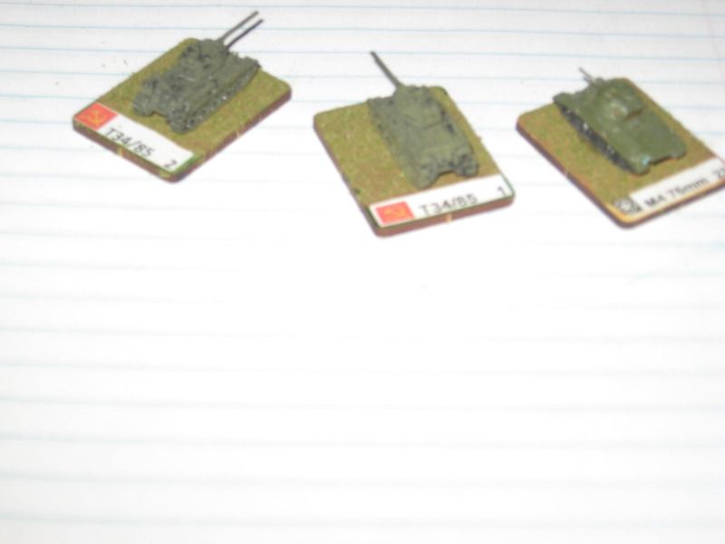

Hi all, here is what I have come up with to label my miniatures, it shows the country, vehicle and number. This is all I need. Jeff
