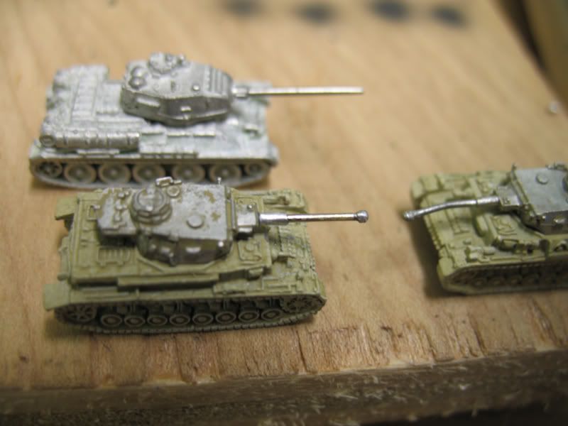

Hey all.
Just messing around with the dremel, solder and some sewing pins and managed to construct some new barrels for some T-35/85's and Pz.Kpfw. IV Ausf F2's.
The T-34 is easy - cut off barrel, drill small dia. hole (same size as replacement pin) with a pin vise. Nip off the end of a sewing pin, chuck into a dremel on low and taper with emery paper to represent the 85mm ZiS-S-53 barrel. Glue in with crazy glue - presto; a non-bending barrel.
The Pz. F2 is a bit more involved. I used foil for the mantlet, wrapping it on the pin. A short length of hollow solder for the muzzle, shaping it into the bulbous muzzle of the 7.5cm Kw.K.40 L/43 - looks very convincing! Mine is on the left - original (complete with all too common bend) on the right :lol:
Troy

A question, though... don't know how much sewing needles cost -- but would brass rod be
(a) cheaper?
(b) sturdy -- or at least sturdy enough to resist most "casual" bending?
I use brass rod in various sizes to "re-mast" or add yardarms, etc., to my 1:1200 / 1:1250 ships. I have read that many use plastic rod for the same purpose, and I can see an advantage to plastic in that it's easier to work with and takes solvent-type cements well -- while brass requires a "mechanical" connection, in the form of glue or solder. But I would imagine that plastic is more fragile... more "breakable"... especially in such small sizes as masts on a ship or a gun barrel on a micro armour tank.
I am going to have to "re-barrel" some of my micro armour (because the cast barrels have broken off), and my current "line of thinking" involves using brass rod -- or in some cases (such as the machine guns in the turrets of PzKfpw I's and II's), piano wire. I've always figured I'd use brass rod... is it "tough enough"?

Hey Tom.
The needles I use are sewing pins - not needles. They are used to alter and hold fabric for sewing. I stole 'em from the wife and I am told they are very cheap - 2.00 for 100. Also they come in various lengths and diameters. They take primer and paint well once roughed up in the dremel and they are almost unbendable when cut to length. Glueing with CA glue holds them in place.
Brass rod is good too, its advantage are it will take solder readily, comes in a variety of sizes, and is maleable. Its chief disadvantage is it is somewhat bendable in the finer diameters.
Plastic - would'nt use it as you already stated. is quite brittle.
Good luck with the conversions!

I know that as one perfects a technique and does it over and over... and over... the amount of time it takes to do a process reaches a (shorter) "standard" time. Roughly -- how long does it take to "re-barrel" a tank? And is there any "trick" to obtaining a uniform length for the new gun barrels? Do you use a "Chopper" or some such cutting device (to obtain a uniform barrel length) and a drill press (to obtain a uniform depth of drilled hole)?
Just trying to "think this all through" before I attempt the process myself... although sometimes, I think I think too much -- I should (to borrow the old commercial phrase) "just do it"!
Hey Tom - I now do tanks in batches, repeating each step ala H. Ford, but it takes apx. 10-15 minutes per tank. I did nine T-34/85s in a couple hours. ( although the PzJg took an evening for 4).
I use the amputated barrel for length. I add the machining and insertion distannce to this and cut the pin with side cutters. I flatten the muzzle end and taper in the dremell. Finally, I drill the hole in the turret after marking the center with a pin to reduce wandering of the bit. I wrap tape on the bit to drill a set depth.
