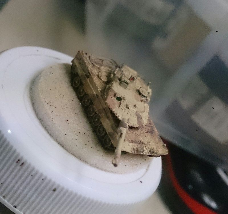

Mech wrote:I tried to do my Leo 2a6 on a desert camo
I don`t think germany sent them to Afghanistan, so there weren`t many photos to use
I found this scheme and tried to replicate
That's a cool pic there Mech...also nice job on your attempt at it as well.

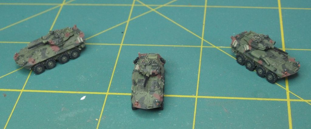

Post by Dog Smack »
Hoth,
The only NATO 3 color cammoed M60s I've seen in the US military have been either static displays at gates or the USMC M60A1s with reactive armor. Not sure when they received the camouflage but I imagine it was in early 90s (guess on my part). I have seen actual pictures of them in a motor pool.
As for the colors I use, I use Vallejo for mine.
Not Leopards or M60s but the colors I used are:
1)white primer
2) base coat Vallejo Camouflage Olive Green (96) + Vallejo White (1) (just enough to lighten the color for scale)
3) brown camo Vallejo Saddle Brown (138)
4) black camo Vallejo Bronze Green (98 )
I also did a black wash on the entire vehicle. I don't do that anymore as it darkens the vehicle too much for my taste.

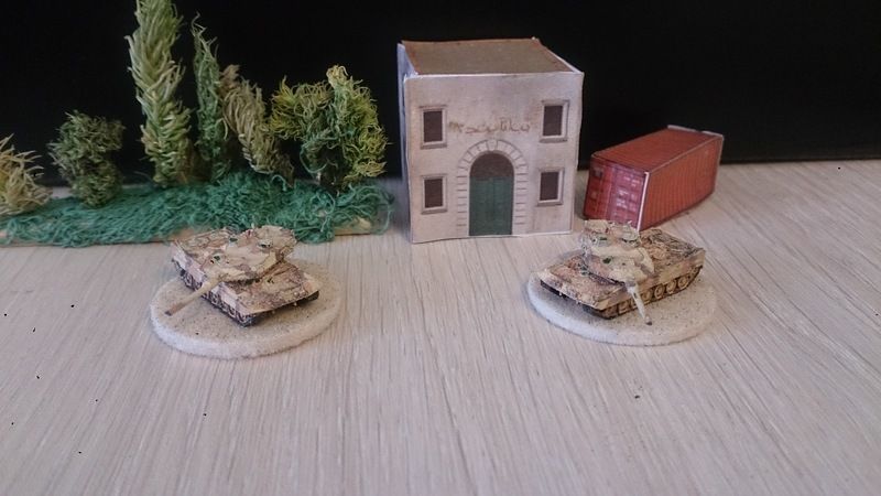

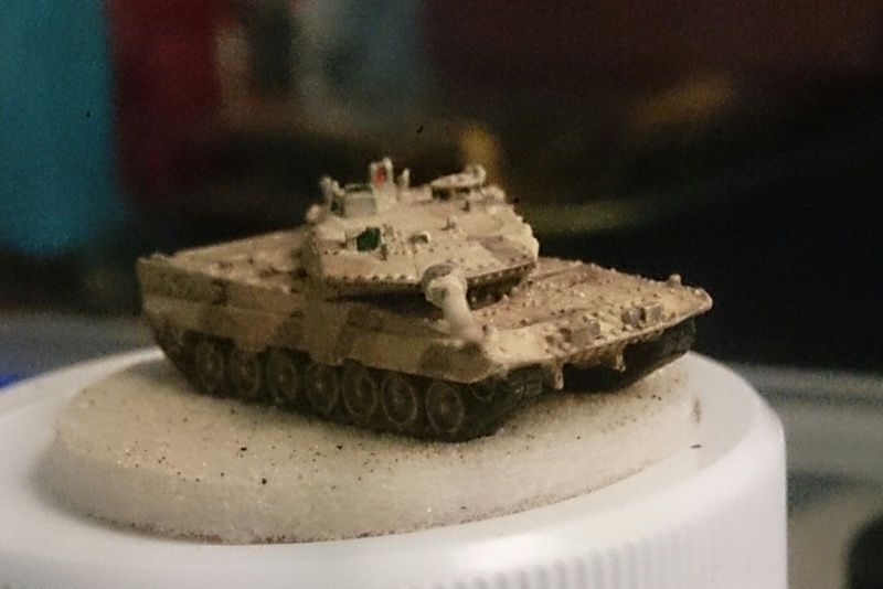

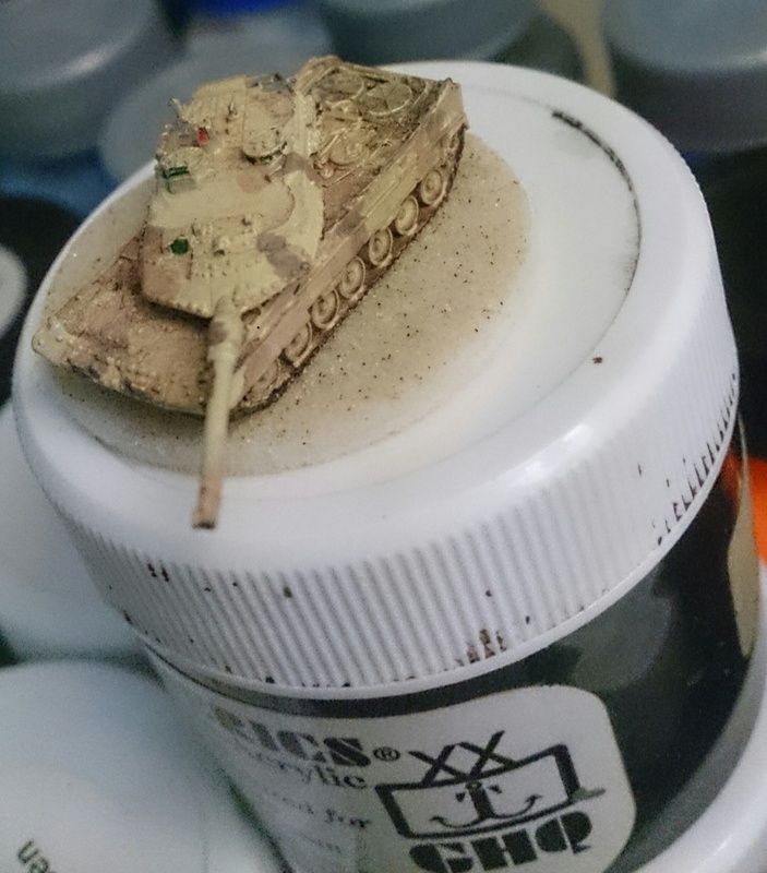

Mech
Posts: 12
Joined: Thu Sep 04, 2014 4:29 am
Post by Mech »
@chris and @hoth: thanks for the compliments
I don't really remember what colors i used
Here in Brazil things get to expensive, so I don't have many models and thus i tend to go to lower end paints, the regular acrylics you find on any paper shop
Though I have some GHQ's range
I primed the Leo with a cheap grey primer, used UK Sand Yellow for the base
The camo was a mix o cheap Salmon (the one i use for the soldier's flesh) and brown, I don't really remember if i mixed them or if i used another color on the mix
Following that I did a wash with a very diluted brown - i used to get it on a medicine dropper, soak it and let it dry, the results are not so good, they get a heavy wash on the lower parts (the tracks are nice), but don't really stick on the details so much
Hoth_902
Posts: 1663
Location: Pacific Northwest
Post by Hoth_902 »
Dog Smack,
Thanks for the tips and really enjoyed your LAV-25s. I have them in the bull pin waiting for me to figure out how I can airbrush in a 670 sqft apartment with only one bedroom. Quick question, and you can PM if you want, but did you sand down the flash on the infantry egress door on the rear of the vehicle? If so, can you send me a picture of the back end? I bought a bunch and they are heavy on the flash for the infantry egress door.
