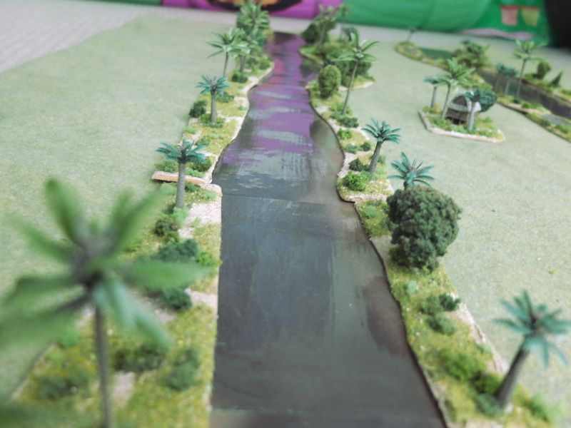

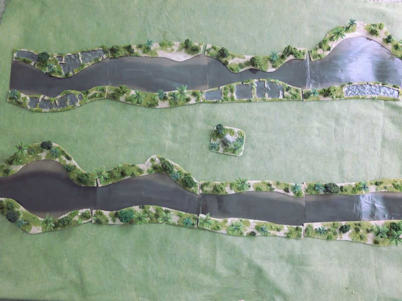

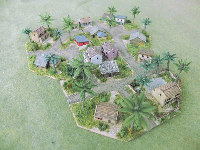

Time to bring back this thread and show some Vietnam terrain I made as part of a commission. The work was to base up some 6mm buildings and make a largish river for 6mm Vietnam gaming. The buildings and palms were provided by my mate and I added a few more Woodlands Scenic trees.
The basing is all on 3mm MDF and the river sections are made from plastic stationery document sleeves. I used 4-5 different types of flock for variety and to create lots of different types of undergrowth and I realise the ground (dirt) should be redder.
The palm trees are cheap ones from ebay I improved a bit. I added some fine sand to around the bottom of the palms where they meet the trunk and also on the top of the tree. Next I painted the trunks and sand part brown to get rid of the shiny plastic look. The palms could be painted as well but I didn't bother.

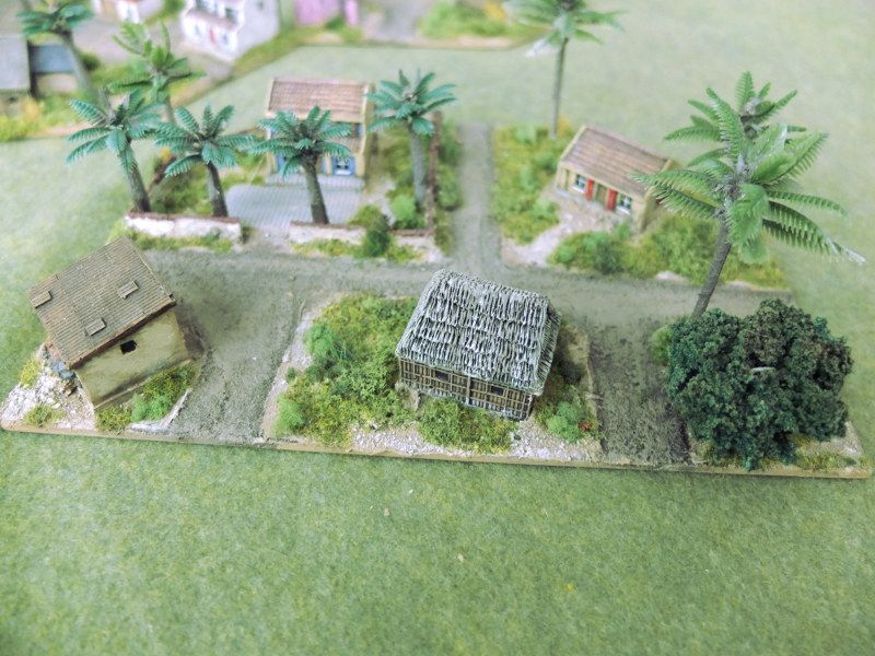

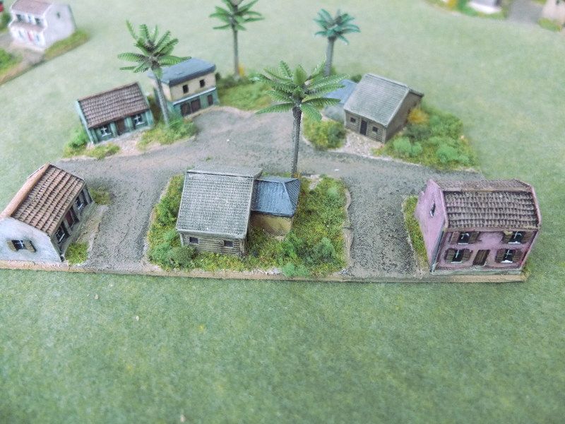

Town sections
These are designed to fit together in any combination but look alright as stand alone pieces as well (I think :D ). The road is made from fine sand and I added lot of bushes but also made sure to keep some empty areas. They probably need more clutter and don't look very lived in and I should have added washing lines, animal fences, debris etc.

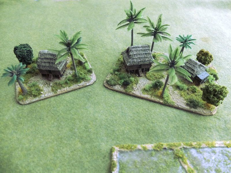

Some hooches

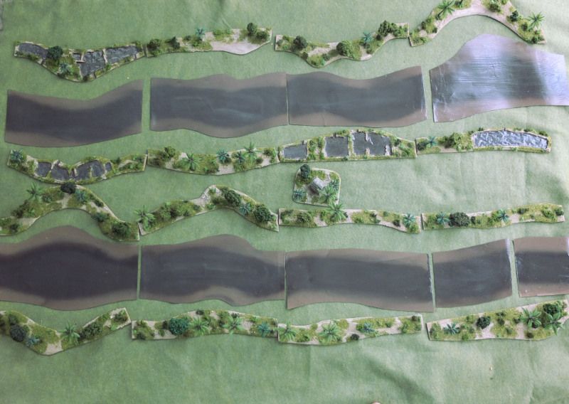

River sections

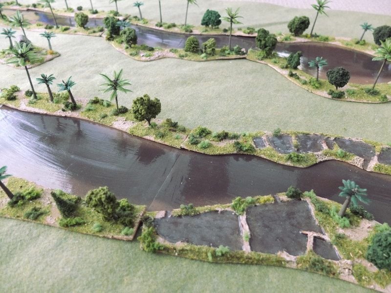

These are meant to be pretty flexible to use but are also a bit of a jigsaw puzzle to put together! The idea is that you can vary the width of the river and even have it lining one edge of the table. Wider river sections could be added pretty easily. The river itself is made for plastic sleeves and spray painted and then covered with PVA glue. I couldn't get rid of the brush marks completely but is a pretty durable way to make thin river sections. Also you can see the paddy fields which I hadn't covered with flock yet.
Image[/URL]
Paddy fields.
My take on making paddy fields and they came out pretty well. The PVA looks whiteish in the pictures but is only very slightly whitish in reality.I probably should have used a resin water but have had problems with it setting before.
