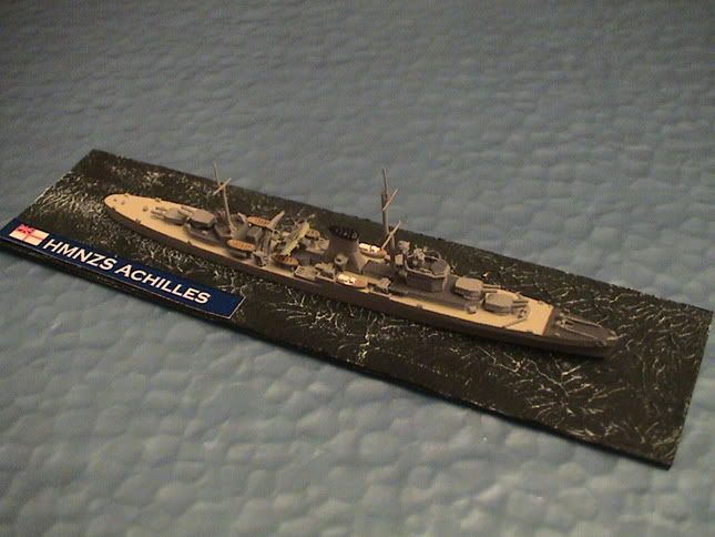

Now for the fun stuff. GHQ's Exexter and Leander kits do not come with the ship's masts and the ships just don't look as good without them. So below I am posting Commodore Harwood's squadron during the Battle of the River Plate. On all three ships I have added the masts and yard arms with various diameters of hobby wire. The addition definitely adds to the appearance and realism of the ships:
Harwood's flagship HMS Ajax
You New Zealanders should appreciate HMNZS Achilles
HMS Exeter
Chris
HMS Exeter
Chris
