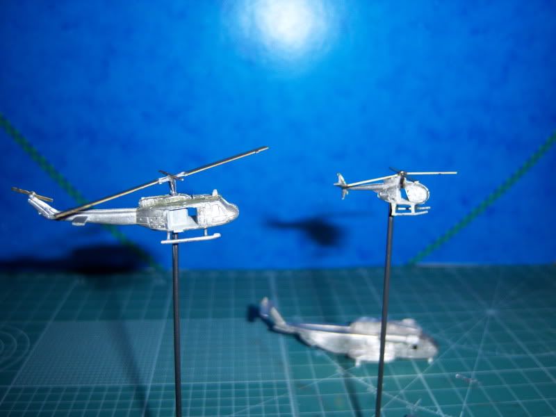

Huey and Cayuse "open version" i need to finish the doors and M60 for huey before the painting job

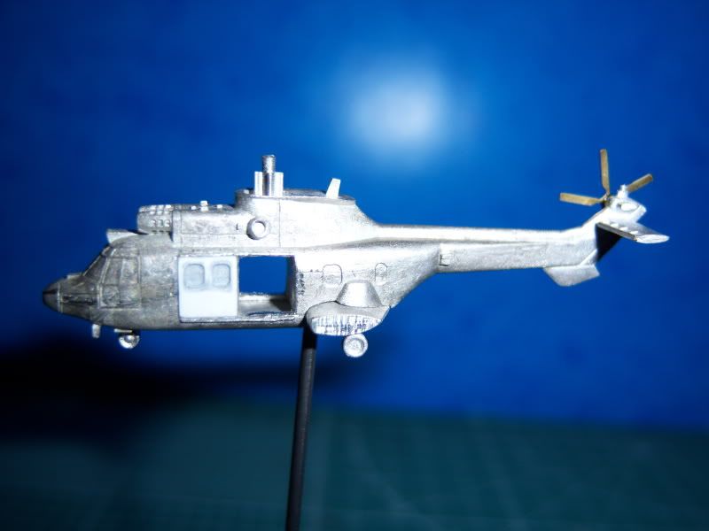

A super cougar for an modern Afghanistan project, i "print" the windows in fresh putty with a tool mades in plastic card :idea:

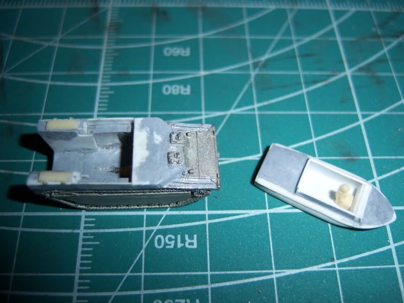

GHQ don't produce yet the LVT4 like it's a big missing for pacific ww2, and indochina War, STAB seal boat to add to the pibber's Vietnam game, :wink: still a lot of work on this one

I love those open doors on your chopers.
I would try to do the same modification too on few personnal Vietnam's choper models I had.

I ask years after years this important model (for Rhin crossing and Netherland campaing) in the "wish list WWII"... :roll:
I hope GHQ will product it next year... :roll:
Keep on scratch building on STAB SEAL's boat. It would be very cool to see it complete !

could you tell us how you opened up the Huey and OH6? please

Nice work on the choppers, but as for the UH-1 and UH-60's they come 'open' out of the box from the other guy, so I can't quite see the reason to go to all that effort if you don't have to. The Super Cougar and OH6 make sense, though.

I got others choppers very fragile, but don't like them, probably from "the other guy"
to open, i use a blade to cut the limit (doors) to remove (around 1mm deep) then i drill several hole with a dremel tool in the door and cut pewter more and more...
I do the same thinh for UH1B gunship :wink:
