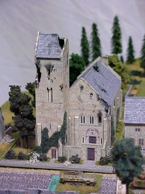

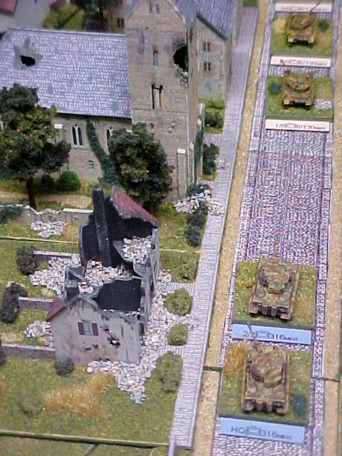

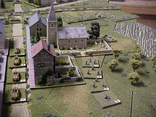

Here are a few pics of churches I have made using paper over styrene. Took quite a bit of time to make the large one.
I had to use about three or four different pictures of churches off the internet to create the "wallpapers"
Hope this "inspires" you to make your own.

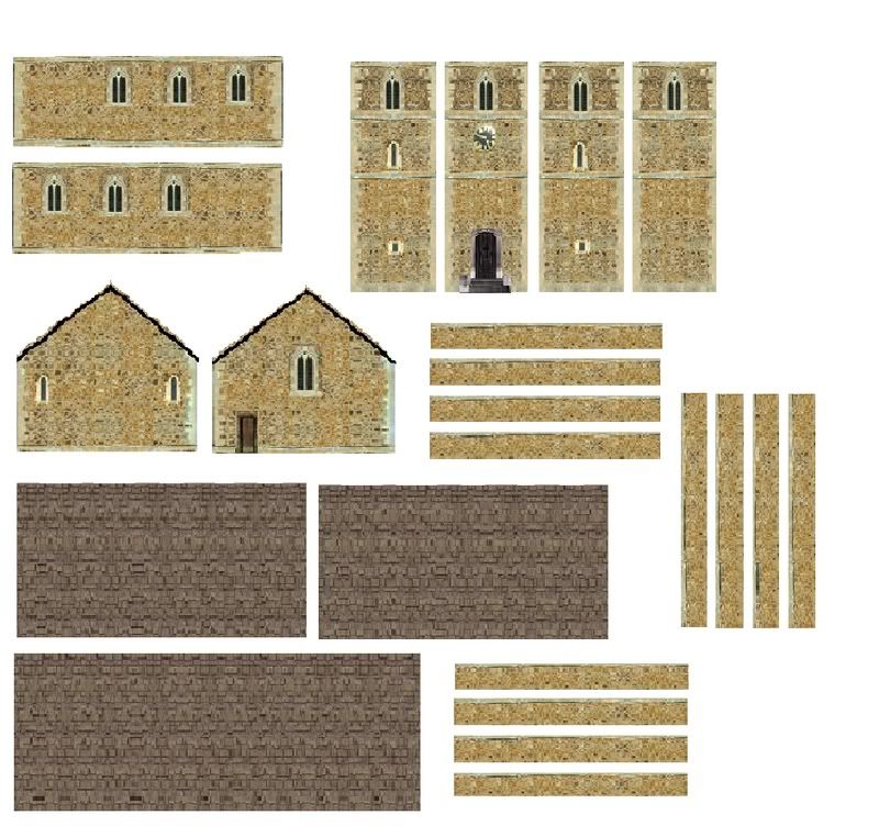

I have to figure out how to convert jpg or bitmap images into pdf. I have Adobe Photoshop but I'm not smart enough to use it yet. Anyhow, here is the wallpaper in jpg. Open it up in the Microsoft Windows paint program and see if you can print it out that way. That's how I do all my wallpapers now.
To get the proper scale, the side wall of the church measures 53 mm long by 18mm high.
You may have to reduce or enlarge the image to get it the right size.
The walls are made from 1mm thick styrene. The roof from .75mm thick. Let the image dry for several hours after you print it so when you cement it to the styrene the ink won't run.. Then use liquid cement to adhere it to the styrene.
