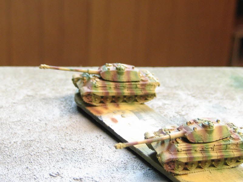

Its my understanding that the tip or nozzle determines the size and pattern of the spray. You might need a different tip or nozzle to get the desired spray. Don't know for sure,just going by what you wrote.WHM wrote: First is, the brush "pulsates". Instead of a steady spray such as what you see from a spray can. I have cleaned the airbrush by spraying cleaner through it but no difference. Second, I can't get a fine spray. It always seems to be a wide pattern.

To get the brush to spray I have to turn the needle fairly far out to allow air/paint to flow.av8rmongo wrote: It could be that the needle is not properly positioned within the airbrush such that even though the spray adjustment knob is full forward the needle is not and therefore never gets down to a fine spray. Just a thought.
Paul
Right now I have the brush disassembled sitting in cleaner in a coffee can to see if that will clean it. Frankly I don't think it really needs it since what I've read on line says all that needs to be done is spray cleaner through it.
As for those tigers, yea! THAT'S what I'm trying for!!
