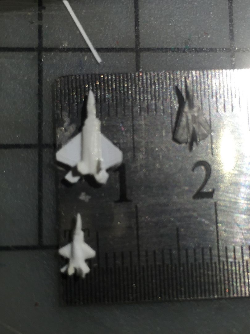

So what do you guys think?

Those are awesome! How did you make them?

redleg wrote:Those are awesome! How did you make them?
Thanks! Made using green stuff
Tried making one from styrene

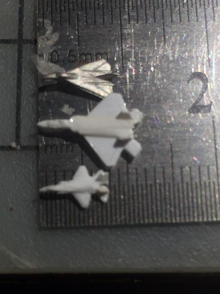

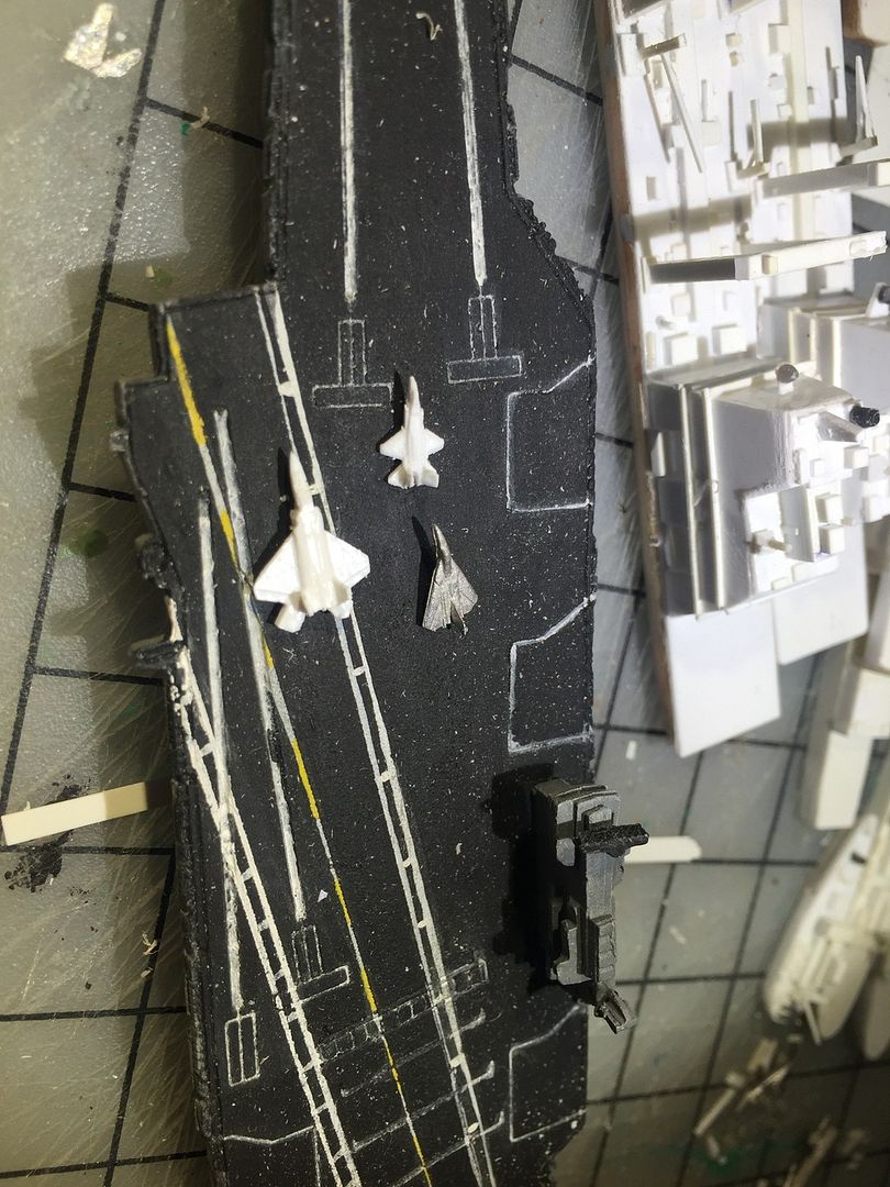

In case you guys couldn't tell this is a F-22 and smaller one is a F-35 next to a GHQ f-111
The F-22 now looks too big?? What do you think?

Post by dragon6 »
nashorn88 wrote:In case you guys couldn't tell this is a F-22 and smaller one is a F-35 next to a GHQ f-111
Put a ruler next to the F-22 or give it's dimensions.
Nevertheless let me compliment you, those are exquisite

Just taking measurements off the posted photo, there are serious scale problems across the board.
I measure the lengths as 4.5 mm for the F-22, 3.0 mm for the F-35, and 2.7 mm for the F-111
For actual lengths, the F-111 is the largest (about 21 m, depending on the model), F-22 is 18.6 m, and F-35 is about 15 m
Assuming the F-111 model is accurate 1/2400 scale, the F-22 should be 2.4 mm in the photo rather than 4.5 mm. The model is about 90% over-scale.
Likewise, the F-35 should be 1.9 mm rather than 3.0 mm. The model is about 60% over-scale.
