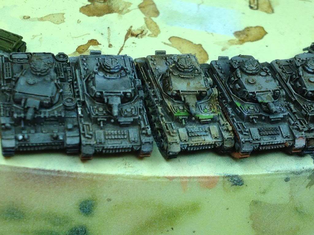

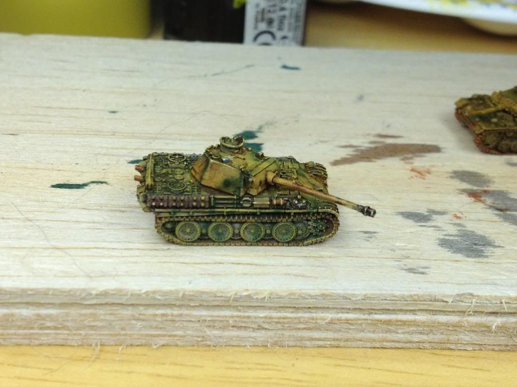

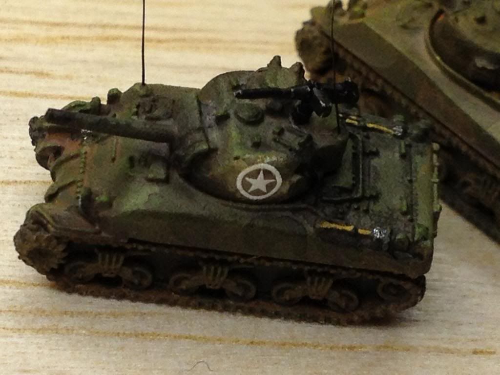

I'm a good painter not great but decent. I suggest getting a airbrush. With a airbrush you don't need to prime which saves a lot of detail of the model.
Just base color then I like to ink then drybrush to hightlight.
Let me see if I can dig up some pic
Also if you already have a coat of paint and wAnt to redo get some gel type paint remover like Jazco not sure of spelling but it the type that you need rubber glove to handle.
It may take a few times to get thick coating of paint off.
It's going to be a lot of work.

Some good painting there.
I can see the possible advantages of using a gloss finish but I'd be worried that anything put on top of the gloss wouldn't have enough to stick to and would eventually rub off.
Painting the flat bits again after applying the wash isn't too much of a burden and keeps everything 'matt'. Hence it's more liable to still be attached to the model in 10 years time.
