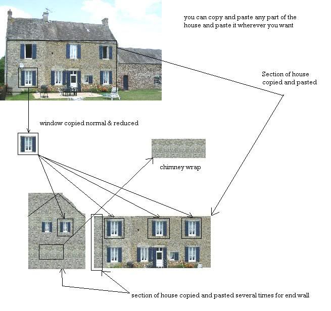

Scott Washburn Wrote:
Here is an example of how I "build" a house using a pic off a website. As you can see the house is skewed slightly but it doesn't matter because I copy and paste only parts of the image. Using the "select" feature on Microsoft paint, and then copying and pasting, it creates a "squared-up" image. I can then copy and paste any portion to create any part of a house. Sometimes when I don't like a particular window or door, I'll use one from another pic and paste it onto the house I'm building. Sometimes you will have to touch up the image by copying small pieces and pasting over the offending areas. If you notice there is some black patio furniture blocking the front door. I copied and pasted small portions of the door over the furniture thereby making a whole door. I did the same for a small portion of the front wall right above the two windows on the right. There was also a small satellite dish on the front of the house I had to cover. The main thing is to find or take a picture that is as square on as possible. I made a church using three different pics which I have posted on the "scratchbuilt" thread.This is quite interesting. So you use photos of whole buildings? I do use photos for my buildings to some extent. For example, the stone is from photos of real stone, the stucco is real stucco, etc. I tried bricks, but the results were unsatisfactory. But most of the other stuff like doors and windows I draw using my graphics program. But how do you get a picture of a real house that's 'flat' enough to use? I mean, if you take the picture from close up there is going to be a good bit of distortion due to perspective and if you take the picture from far enough away to eliminate that, you would lose some detail, wouldn't you? I mean I can't argue with your results, but I'm curious about how it was achieved--especially since I'm a lousy photographer
Mike G.
