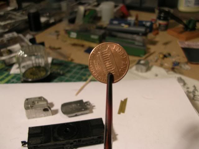

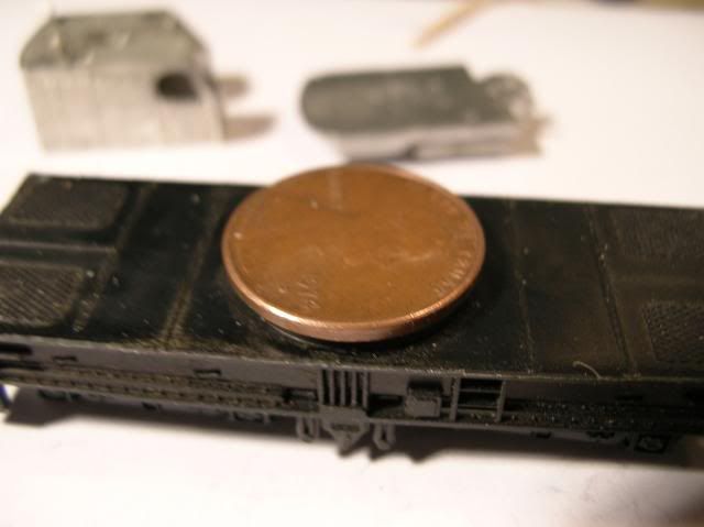

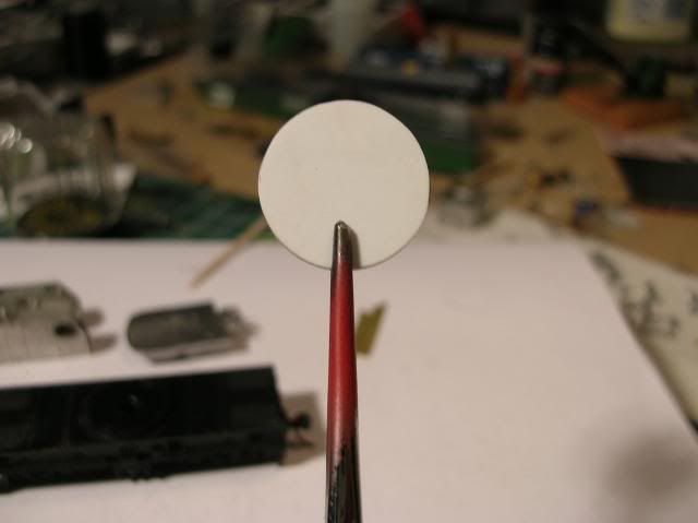

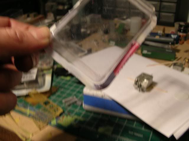

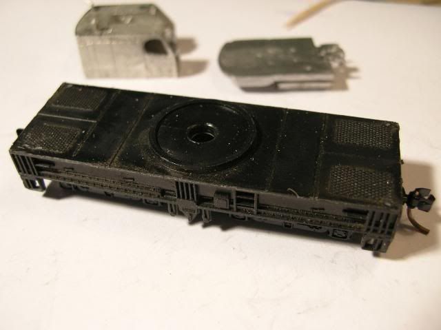

As in pass mobile crane builds I need to make the base plate solid/flat to do this I use a penny as a tmeplate
I trace the penny onto a pecie of plastic,no size really jsut what is sitting on the hobby table and what is easy to find,cut it out
once it's cut out I file it smooth on both sides this helps thin it out and preps for primer.
and here is the base in place with the crane cab

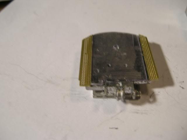

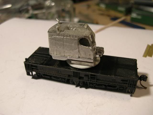

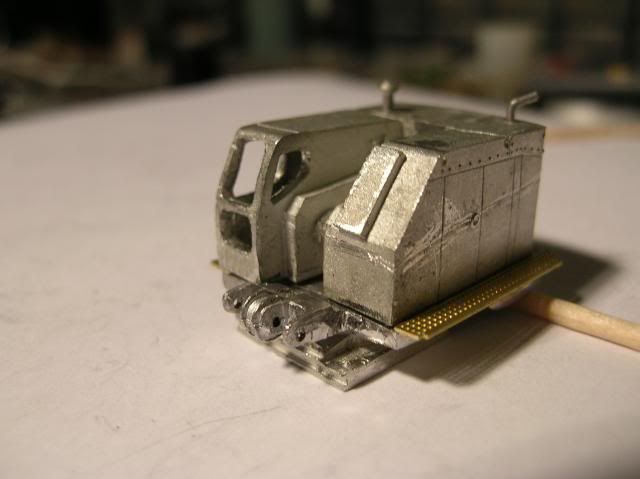

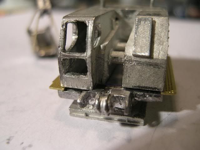

Problem!!! witht he cab body on the deck I can see a gap,this is from using the GHQ catwalks which HAD to be used becasue its just a super detail part and HAd to be used !! The gap is hard to see but it's there,
What do you do? what do you do only need something really thin !! I live to far from anywhere that would have anything I could use,mmmmm "think pinky,thinky'
YEAH !!!!!!!!
Cut out what I needed and hten trimmed ot fit
got a really good fit once it's painted it should bleand right in,I hope ???

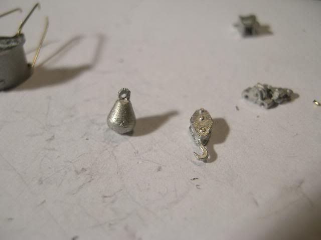

SO this is where LMMM stands out from the crowd,even if N scale in the UK is 1:148 I can live with that when it comes to detail parts,they win hands down,Trust me the pictures do not do them justice.
The other area that that win hands down in in this one kit I have 4 options wreaking ball,drag line,clam shell and hook !! what I don't use here I can use later or make a laod for a trailer or flatcar

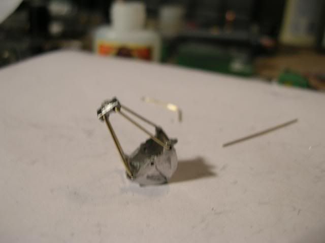

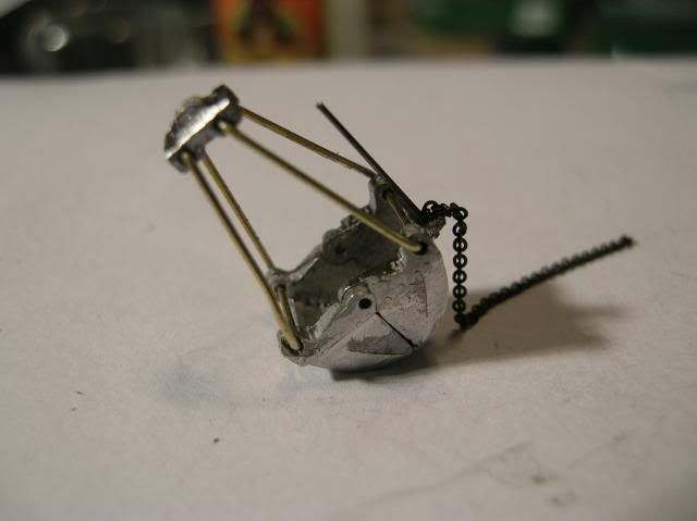

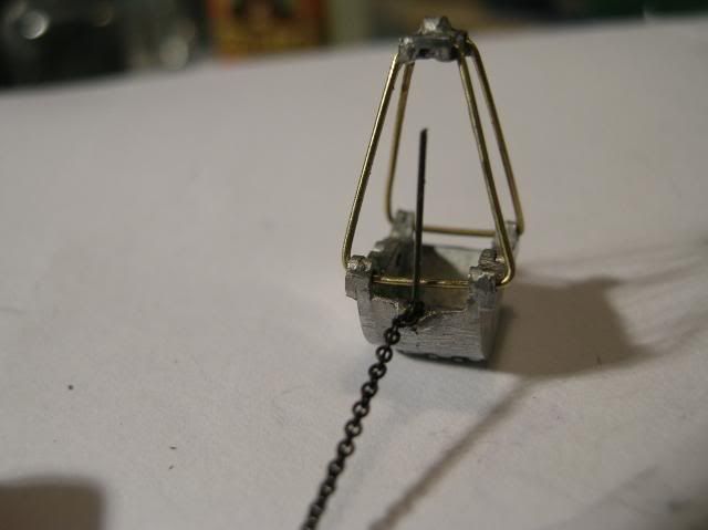

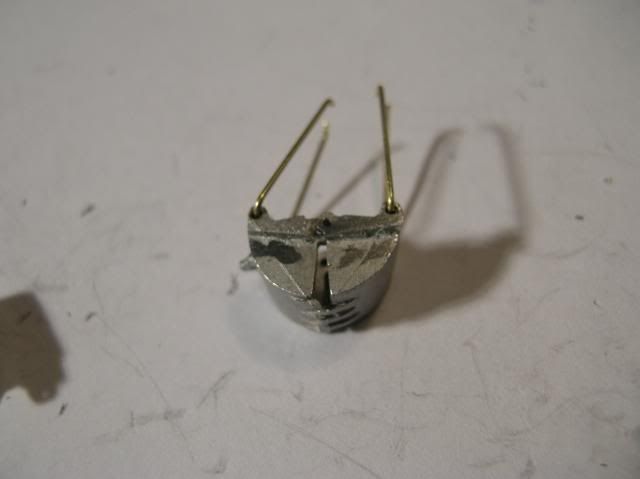

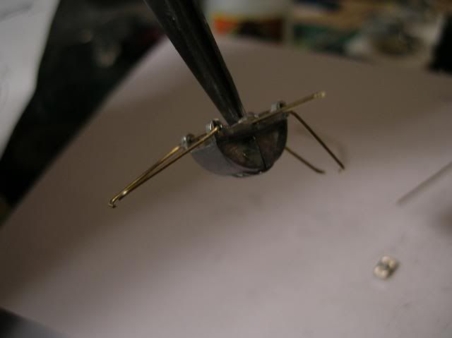

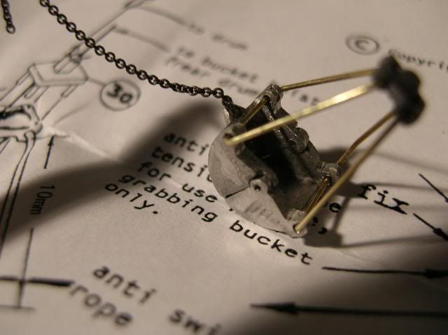

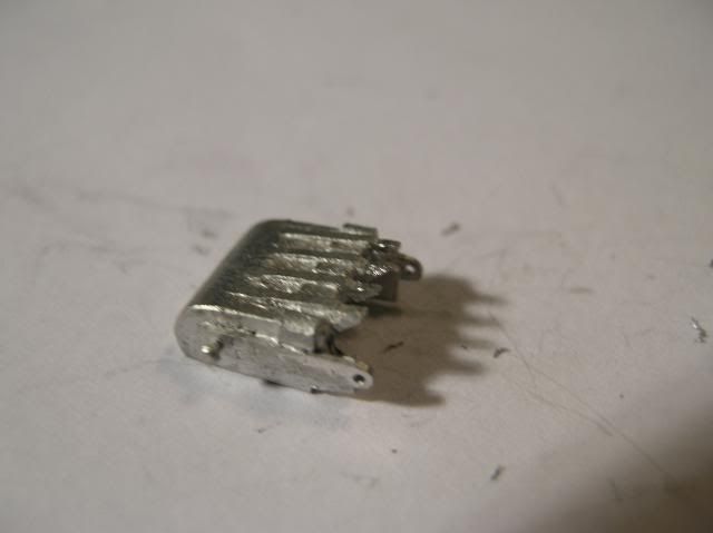

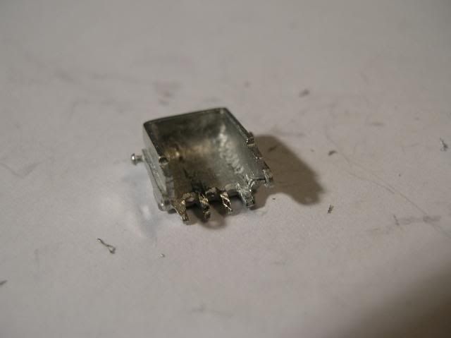

SO as much as i wnated to do a dragline the cleint wants a bucket so its a bucket here is both sides glued rom the inside and with teh 9mm rod bend and in place,For the life of me for the hunders of GHQ buckets I have built I still can't seem to bend the little PE parts the right way The LMM is really easy,this time out I built the rods as one long rod ,each side I ahve buit it with four rods.
Here is the bucket rods glued in place on the top section there

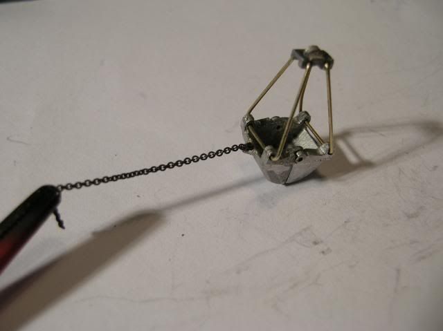

One side of the shell has a small tab,I drilled out the hole this is for the anit-swap cable,wait way one or peice of black thread,a fast look see on the hobby table annd I find some N scale chain and some super hard but super thin wire !!
here you see the wire threaded thur the chain bottom bit as been cut and glued
pulling the chain tight as the glue dries
top section of wire cut to a wee tiny stub and glued !! I'm happy I have cut the shell before and the chain looks soooooooooo much better

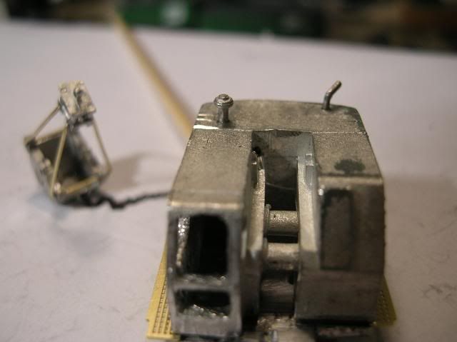

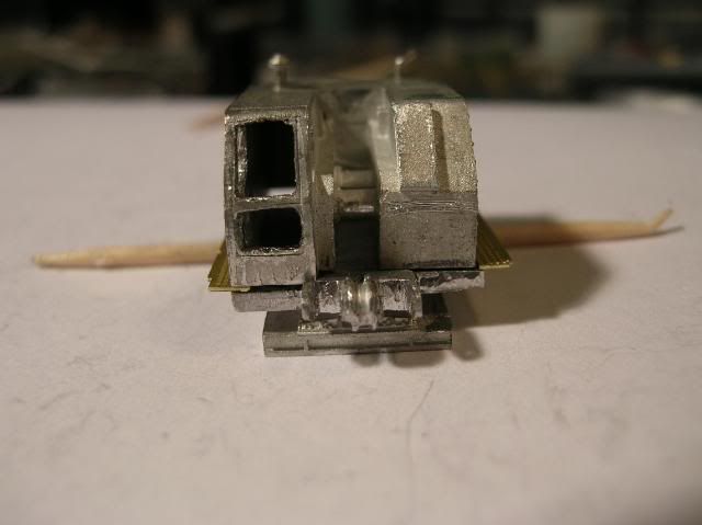

SO is this a problem or me being to nit picky The GHQ body comes with two reels the way I have built this I need one relel for the boom,one reel for the bucket,one reel for the closed bucket cable and one for the anit whatever cable,The cable for the boom will come out of the body,I drilled a hole on the back side it will be feed thur the bottom inside the end wrapped around a toothpick and glued then thur the hole to the boom and to the back reel,
the front reel will go to the bucket and the sway cable to the reel in the front below the body
Question is I still need a fourth reel for the close cable ?? or am I reading to much into this ???
- Posts: 451
- Joined: Mon Mar 21, 2011 2:26 am
It's not a big deal. Anybody who was never in it wouldn't know the difference. Leave it that way or carefully paint the hose over red. With the level of detail you did you should be nothing but happy with the work.nmanica wrote:BC,I'm sitting here slamming my head into my desk !!!!!!!!!!!!!!!!!!! Thats the one you see fire fighters use on car fires and stuff !!!!!!!! God this getting old BITES !!!!!!!!!!!!! so I have made notes and thank you for the infor and thank you in advance for the invite for more infor !!!
