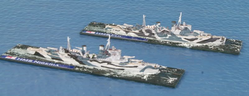

Base is covered with Vallejo Water Gel. I work in the bow wakes and waves after placing the ship on the base. I have already mixed a dark sea blue into the gel. Once dry, the waves are dry brushed in flat white to pick out the detail. I then apply a coat of Vallejo gloss varnish mixed with a drop of Vallejo transparent blue in a 20 - 1 ratio (the higher is the gloss varnish). Here are some of my results:
Image[/img]
Hope this helps,
