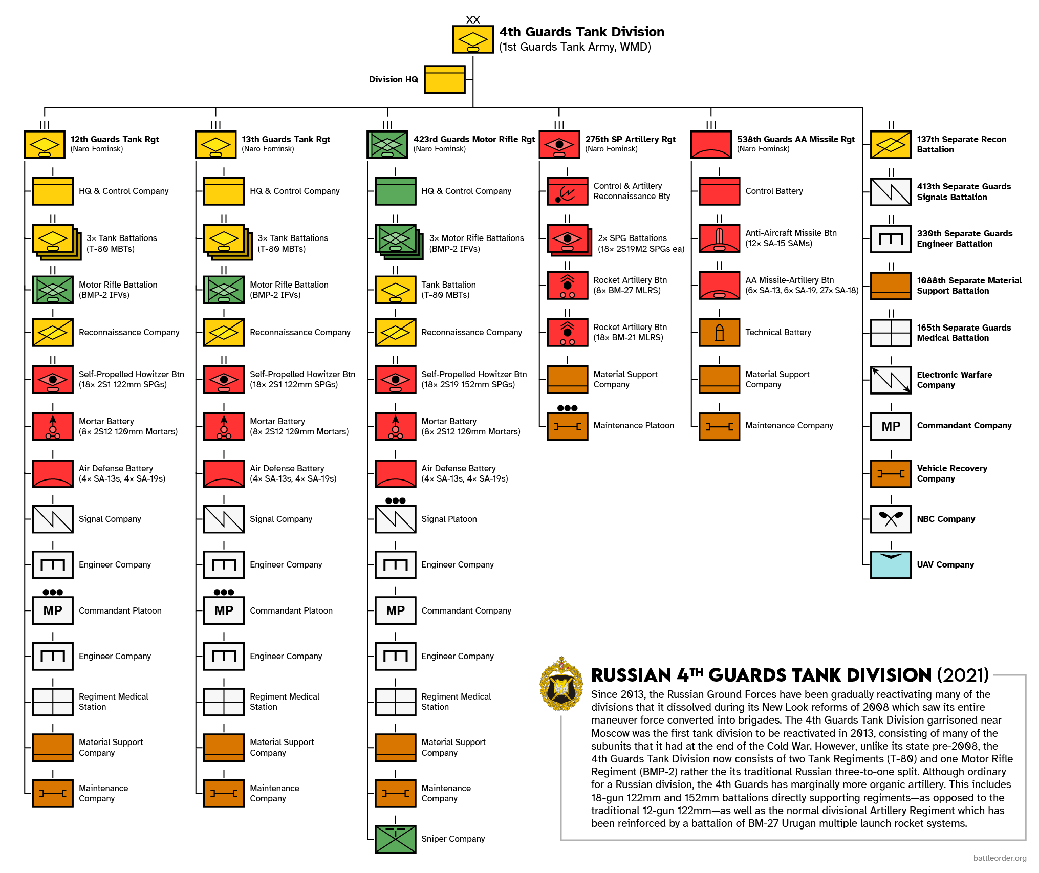

Re: Battalion Tactical Groups
Here are some pictures of the organization
