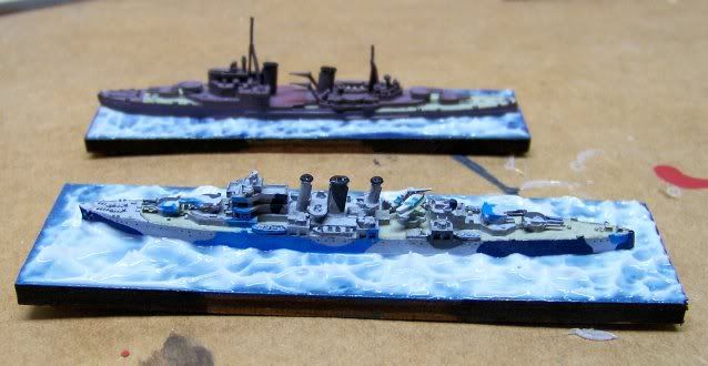

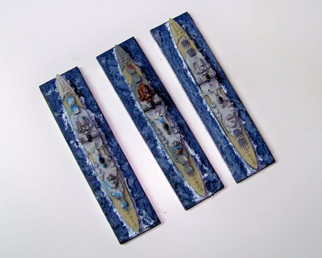

I wanted to expand this topic by asking how do you base the ships. I couldn't find around any description or picture of the basing process of the ships.
I would like to add some waves and some sea foam. But how do you proceed?
I downloaded almost all the pictures of the micronauts topic, but I can't figure out how those waves are so nicely done.
Thank you!
Luca
Ars & Mars
Military vehicles are beautiful because they are built from functional designs which make them real, solid, without artifice. The short timers
Erst wägen, dann wagen (first consider, then risk) von Moltke the Elder
Jmrino
Posts: 27
Joined: Wed Oct 12, 2005 12:04 am
Ship bases
Post by Jmrino »
I use 1/8" plywood bases with a base coat of whatever sea color, then apply a layer of gel medium.... then stipple with a tootbrush to create waves...
It dries clear......
Then dry brush some wake and whitecaps.....
Finally, I hit the whole thing with some clear acrylic.
Anyway, my .02

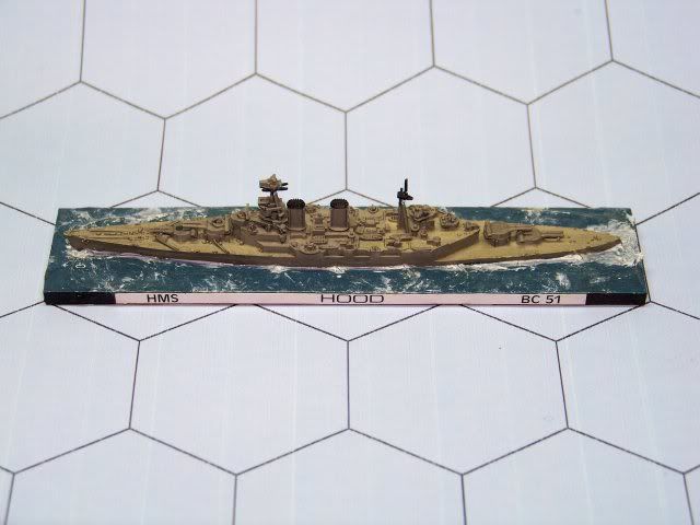

Luca
Posts: 364
Joined: Fri Feb 18, 2005 11:52 pm
Location: SLC
Post by Luca »
Thank you.
What kind of gel do you use? Is a specific hobby gel or something I can find in an hardware store?
So, you first prepare the base, make the waves, and glue the ship.
I like also the idea of printing the name on the base side.
